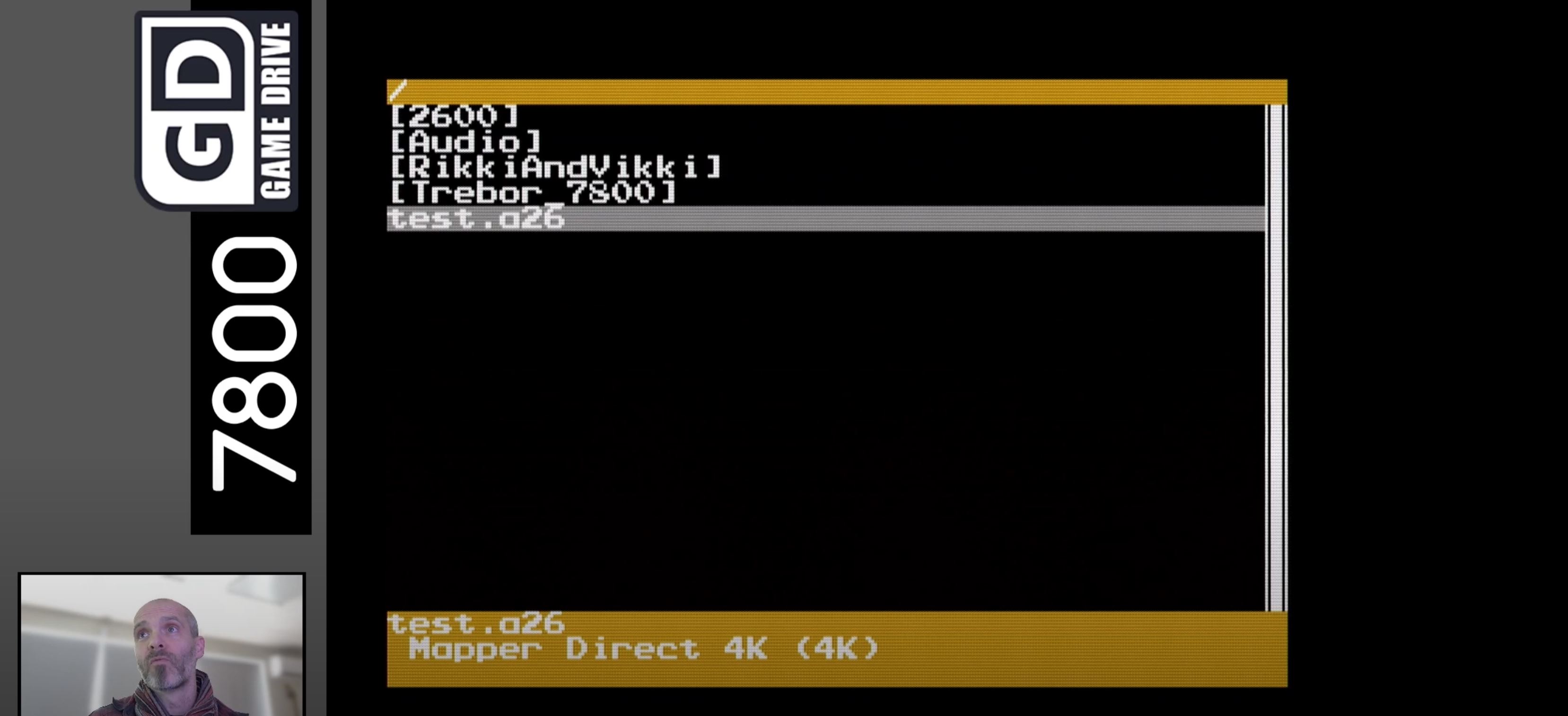

Nachdem er bereits mit riesigem Erfolg u.a. die GDs für den Jaguar64 und den Lynx rausgehauen hat,
folgt nun der nächste Streich: Das neue Gamedrive für die 7800 😎 !
https://www.youtube.com/watch?v=xGKEnCuZdBM
A first look at the 7800 GameDrive cartridge, a way to play your old Atari 7800 (and 2600) games from a memory card on your 7800.
Support for all commercial game mappers for 2600 and 7800 as well as RGB and stereo audio out via MegaDrive 2 style mini-din on the cartridge itself.
Audio support includes DUAL POKEY, YM2151 and TIA.

Description
The RetroHQ 7800 GameDrive cartridge allows you to play all your Atari 7800 games and homebrew directly from a memory card with many other extras built in!
The 7800GD has all the additional audio chips you'll ever need, including 2 POKEY chips for DUAL POKEY music, a YM2151, COVOX audio for sampled sound and BupChip for blasting sampled music.
The 7800GD also features a unique RGB video and audio out port on the cartridge iteself allowing you to play your 7800 (and 2600) games in glorious RGB using a compatible Mega Drive 2 style video cable!*
As if all of this wasn't enough, the 7800GD also allows you to break into your games, save your state, load previous states, enable cheats or just return to the game menu and load another game. And to make all of this even easier, there is also the Mega 7800 which allows you to use Mega Drive and MasterSystem controllers on the 7800 and access game breaking features at the touch of a button!
